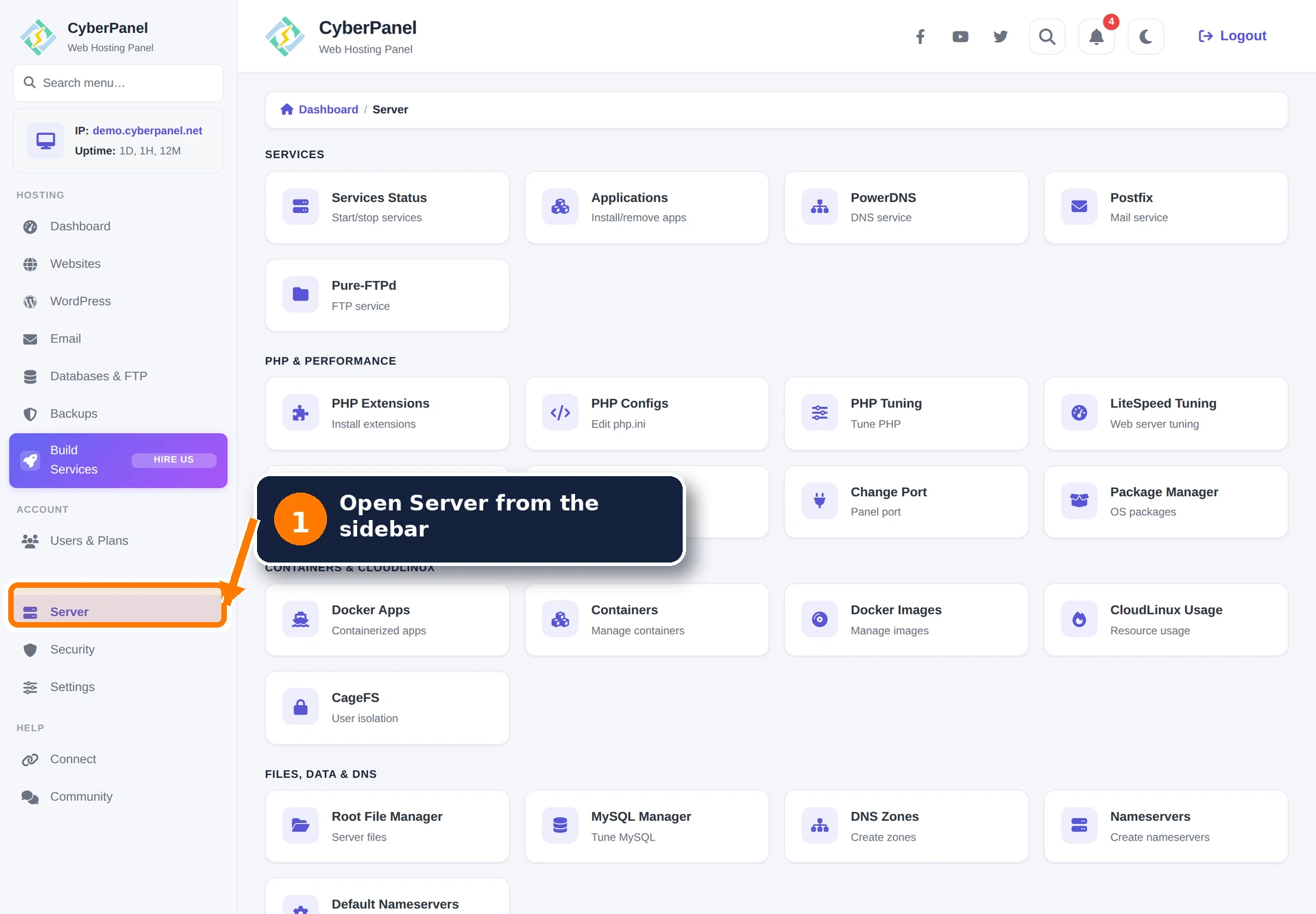

Step 1: Open Server
Sign in to CyberPanel and select Server in the left sidebar.
CyberPanel Server page with an arrow pointing to Server in the sidebar
Open the Server workspace.

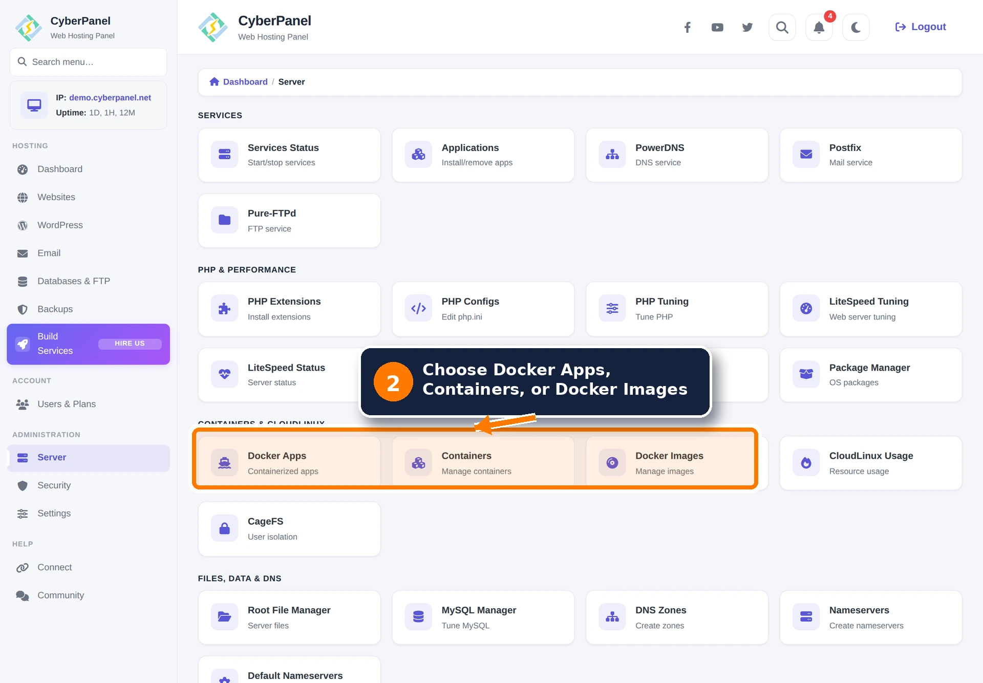

Step 2: Choose the Docker tool
Scroll to Containers & CloudLinux. The three Docker entries have different purposes:
  • Docker Apps: deploy a supported application with a domain, owner, resource limits, and application administrator account.
  • Containers: create, start, stop, restart, inspect, configure, export, recreate, or remove individual containers.
  • Docker Images: search Docker Hub, pull a tag, review local images, and remove images that are no longer required.
CyberPanel Server page highlighting Docker Apps, Containers, and Docker Images
Choose the Docker tool that matches the task.

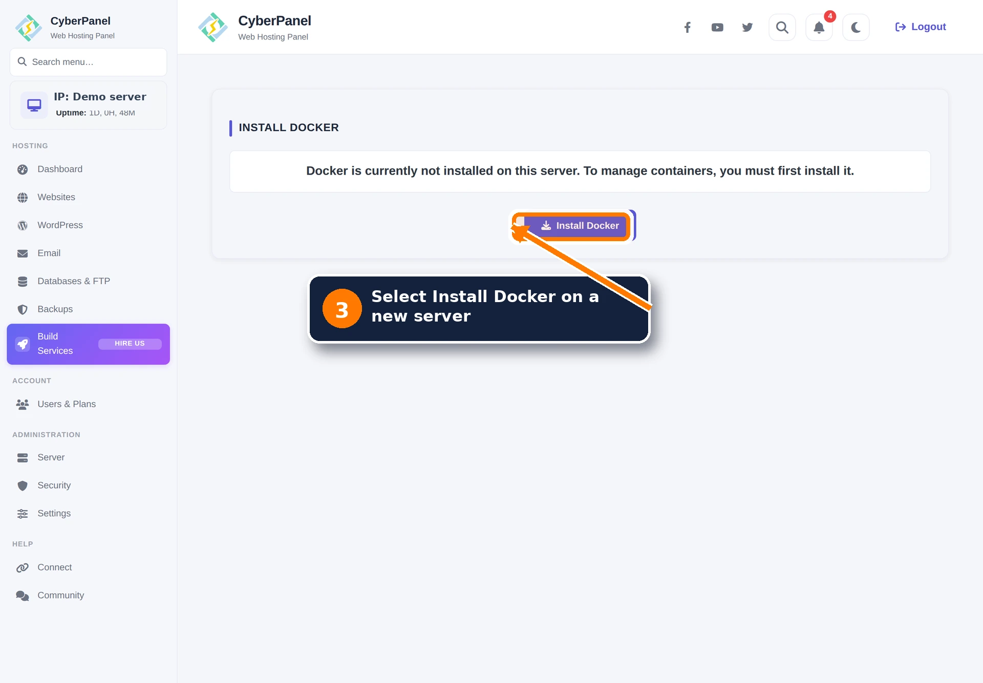

Step 3: Install Docker when prompted
If Docker is not installed, CyberPanel displays an installation page. Select Install Docker once and allow the installation to finish. Do not close the page, restart the server, or run a second package installation while it is working.
CyberPanel Install Docker page with an arrow pointing to Install Docker
Install Docker from CyberPanel when the server does not already have it.
The installation workflow was validated through CyberPanel on Ubuntu 26.04. Docker Engine, Docker Compose, and the Docker service were installed successfully, and the service was enabled for startup.
