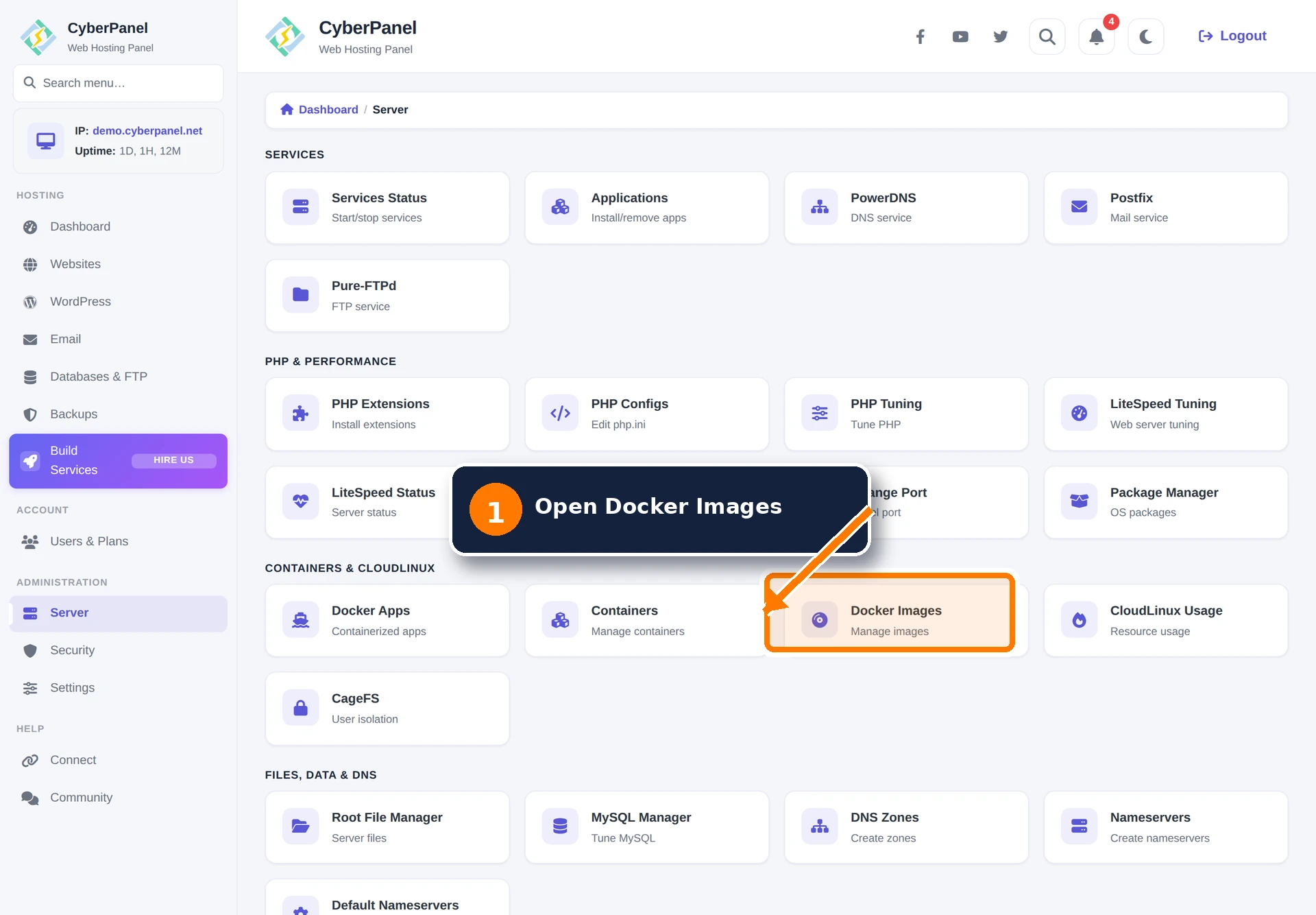

Step 1: Open Docker Images
Open Server, scroll to Containers & CloudLinux, and select Docker Images.
CyberPanel Server page with an arrow pointing to Docker Images
Open Docker Images from the Server workspace.

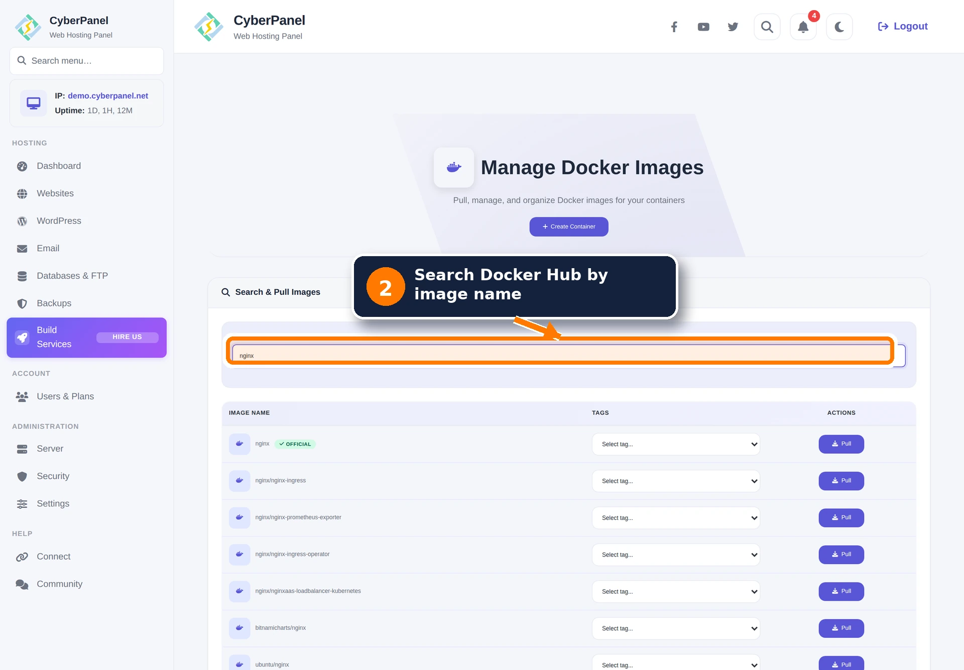

Step 2: Search Docker Hub
Enter an image name in Search Docker Hub. CyberPanel displays matching repositories while you type. Prefer the result marked Official when it is maintained for the software you need.
CyberPanel Manage Docker Images page highlighting the Docker Hub search field
Search for the required image.

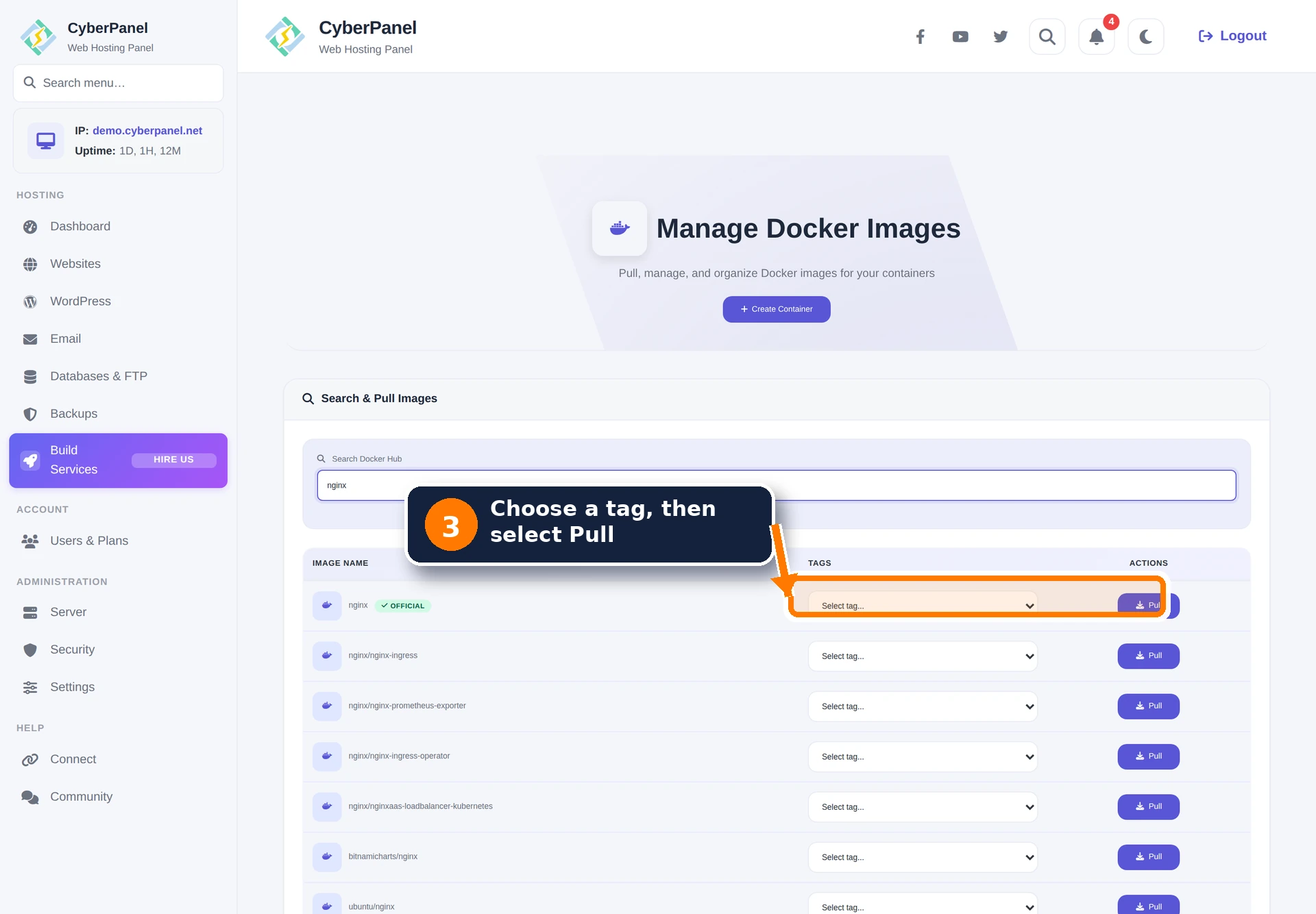

Step 3: Select a tag and pull the image
Open the tag list for the correct repository, choose the required version, and select Pull. Use an explicit production tag when possible so a future image update does not silently change the application version.
CyberPanel Docker image search result highlighting the tag selector and Pull button
Select an image tag, then pull it to the server.
Verify the source: similarly named community repositories can contain different software. Confirm the repository owner, documentation, supported architecture, and tag before pulling an image.

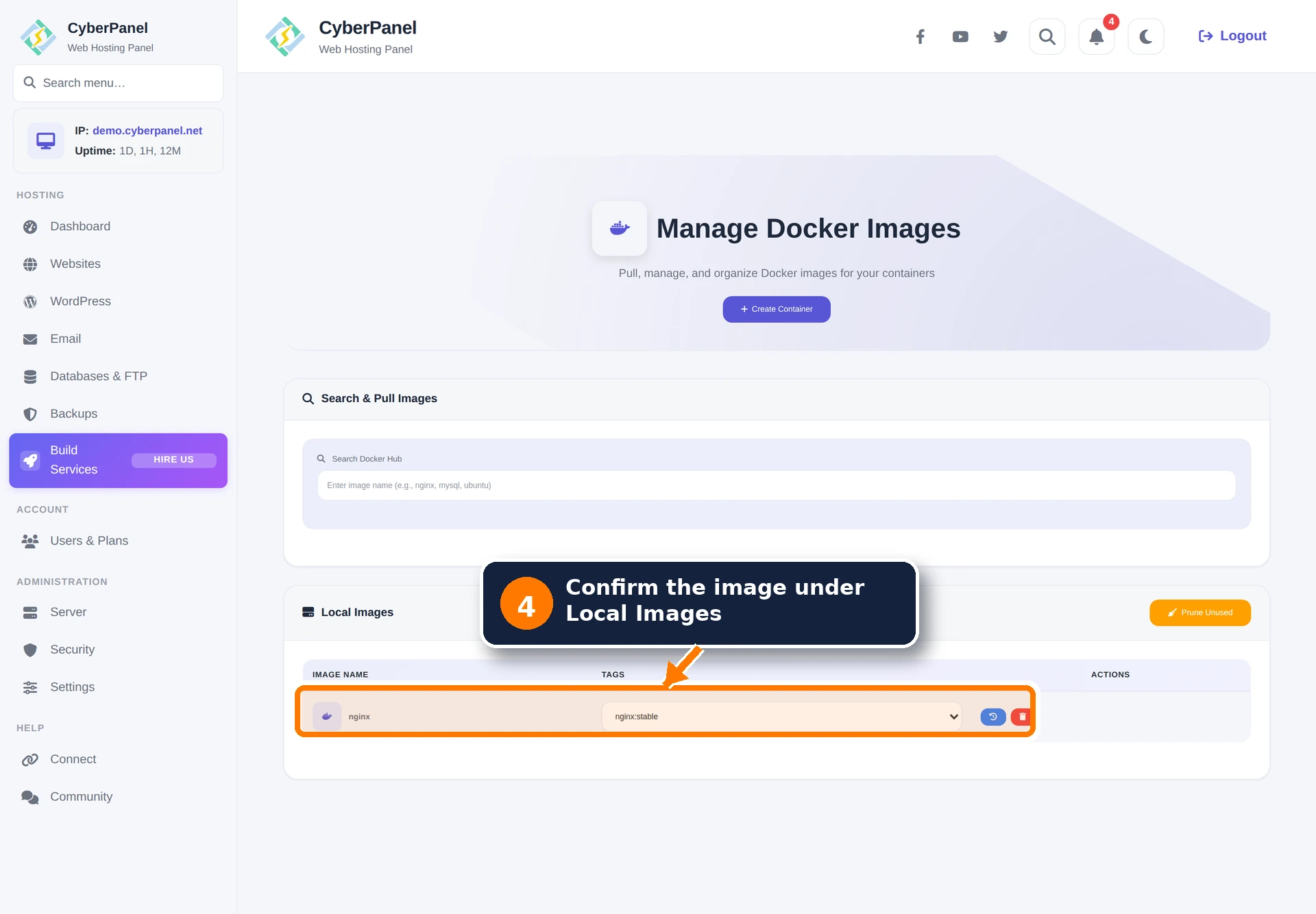

Step 4: Confirm the local image
After the pull completes, the repository and tag appear under Local Images. The blue history action shows image history, and the red action removes the selected local image.
CyberPanel Local Images table highlighting a pulled nginx image
Confirm the repository and tag under Local Images.
Remove unused images safely
Delete a single tag only after checking which containers use it. Prune Unused removes images Docker considers unused, so review the server before running it. An image can still be important for a stopped workload or a planned rollback even when no running container uses it.
