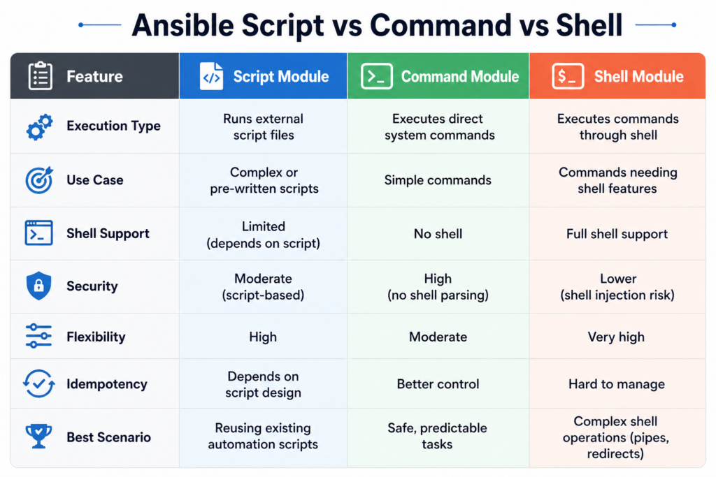

ANSIBLE SCRIPT VS COMMAND VS SHELL

When You Have To Avoid Ansible Script?
Avoid when:
  • a native Ansible module already exists
  • you need strict idempotency
  • you want detailed state control
In such cases, native modules provide better reliability.
