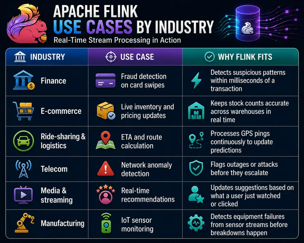

Common Apache Flink Use Cases
Apache Flink typically addresses use cases where real-time data processing is a critical requirement.
APACHE FLINK USE CASES BY INDUSTRY
Many of the companies in this space run production-grade Apache Flink workloads at large scale, including Alibaba, Uber, Netflix, and ING Bank.
