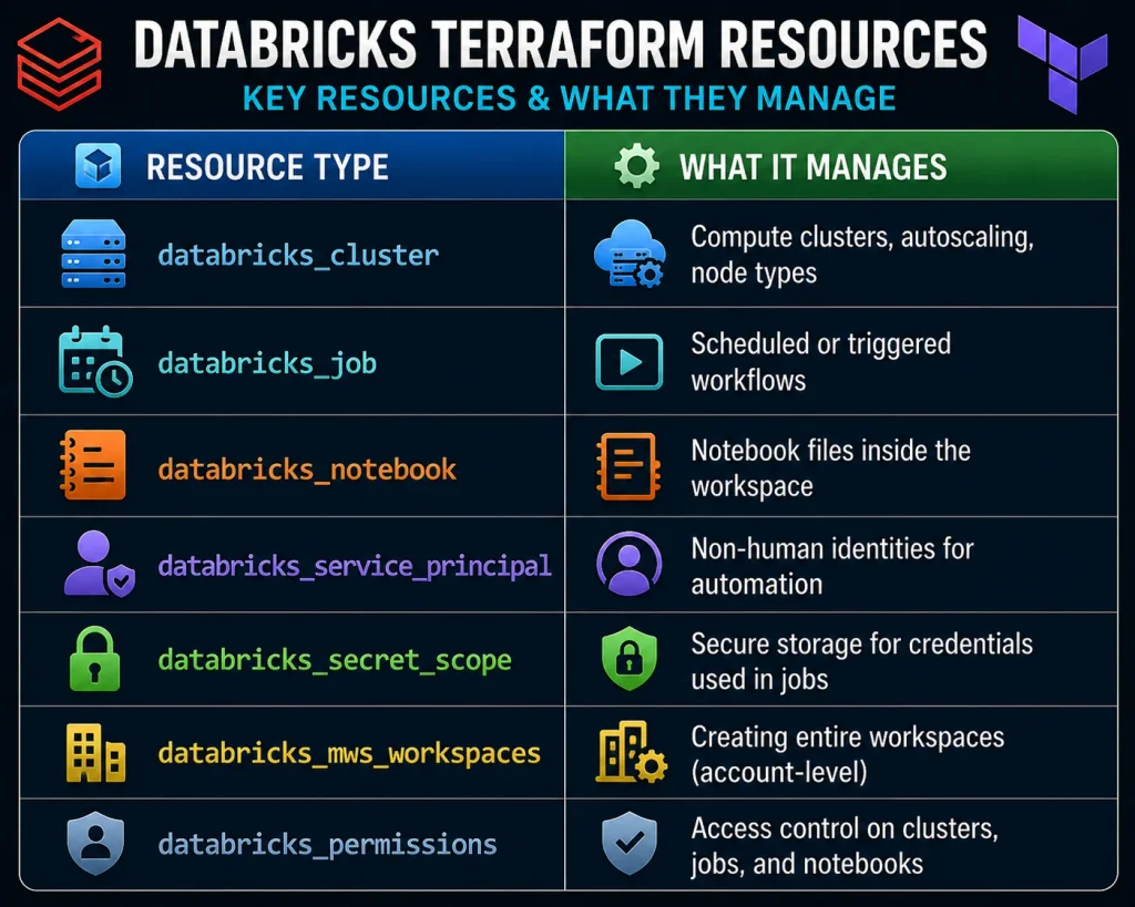

Common Resource Types You’ll Work With
The provider covers a lot of ground. These are the ones most teams touch first.
DATABRICKS TERRAFORM RESOURCES
