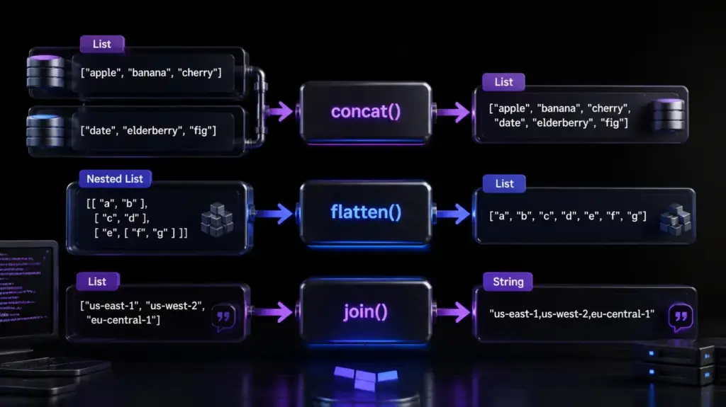

Terraform Concat vs Flatten
These two functions can look similar because both work with lists, but they solve different problems.
concat()
Use concat() when you have separate lists that should become one list.
concat(
  ["web", "api"],
  ["db", "cache"]
Result:
  "web",
  "api",
  "db",
  "cache"
flatten()
Use flatten() when you have nested lists and need to remove the nested list structure.
flatten([
  ["web", "api"],
  ["db", "cache"]
Result:
  "web",
  "api",
  "db",
  "cache"
The output can look identical in simple examples, but the input structure is different.
A useful way to remember it is:
  • concat() joins separate lists.
  • flatten() removes nested list levels.
If your data already consists of separate lists, use concat(). If a list contains other lists, flatten() may be the better choice.

Terraform Concat vs Join
The easiest way to distinguish the two functions is to look at what you need as the final result.
FunctionInputOutputMain use
concat()Two or more listsOne listCombine lists
join()Separator + list of stringsStringCombine strings
flatten()List containing nested listsFlat listRemove nested list levels
Terraform concat vs flatten vs join for lists and strings

Should I use concat or join for strings?
Use join() when you have a list of strings and need one string as the result. concat() produces a list, while join() produces a string using the separator you specify.
Final Takeaway
Terraform concat() is a simple way to combine two or more lists into one collection. It keeps the elements in their supplied order and does not recursively flatten nested lists.
  • Use concat() when your problem is combining lists.
  • Use flatten() when your problem is nested lists.
Use join() when your goal is turning a list of strings into one string.
When you are unsure how an expression behaves, test it with terraform console before adding it to a larger configuration.
