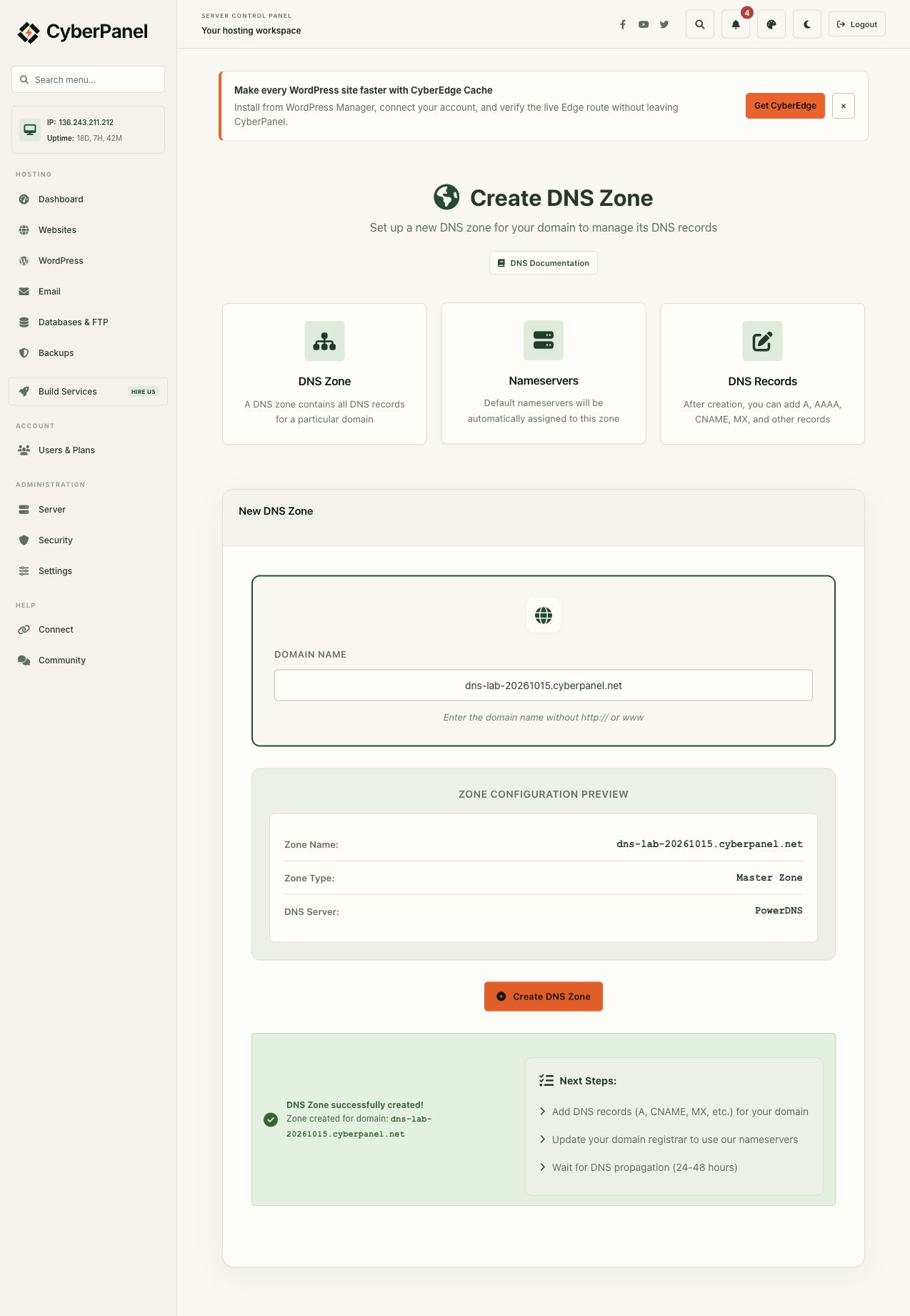

2. Create the zone in CyberPanel
Open Server → DNS Zones and enter the domain you intend to manage. We enter dns-lab-20261015.cyberpanel.net, submit the form, and confirm that the zone appears in the interface. Creating a separate lab zone keeps the exercise away from the parent domain’s website and mail records.
CyberPanel Create DNS Zone form populated with the isolated lab domain
Step 1: create a dedicated zone using the real CyberPanel DNS form.
Next, open DNS Records Manager at /dns/addDeleteDNSRecords and select the new zone. Review what CyberPanel has already generated before adding anything. Automatic defaults are a starting point; they still need to match your intended web, mail, and nameserver setup. Duplicate records with different values can produce confusing results later.

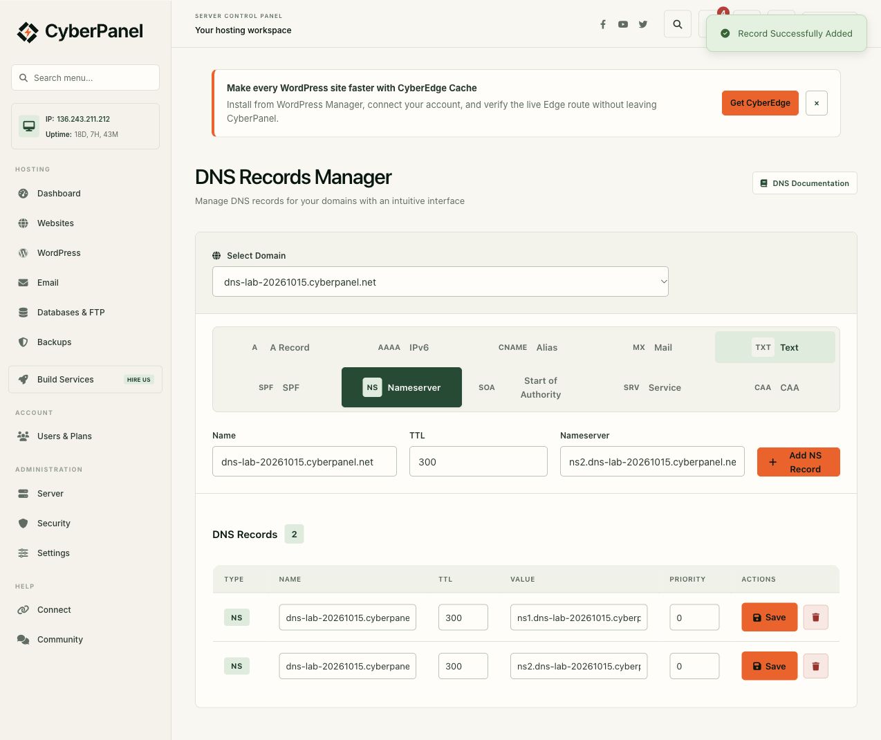

3. Create nameserver hosts and inspect NS and SOA

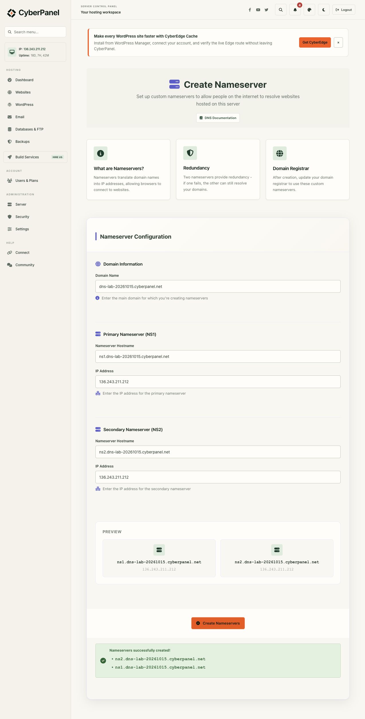

Use Create Nameserver to enter the two nameserver hostnames and the lab IP address. Then inspect the zone’s NS records. An NS record names a DNS server; an A record supplies its IPv4 address. Because these nameserver hosts live inside the child zone itself, the parent also needs address information, known as glue, to let a resolver find them.
CyberPanel nameserver creation result for the lab nameservers
Both nameserver labels use one test IP. This is a single-server lab, not a high-availability configuration.

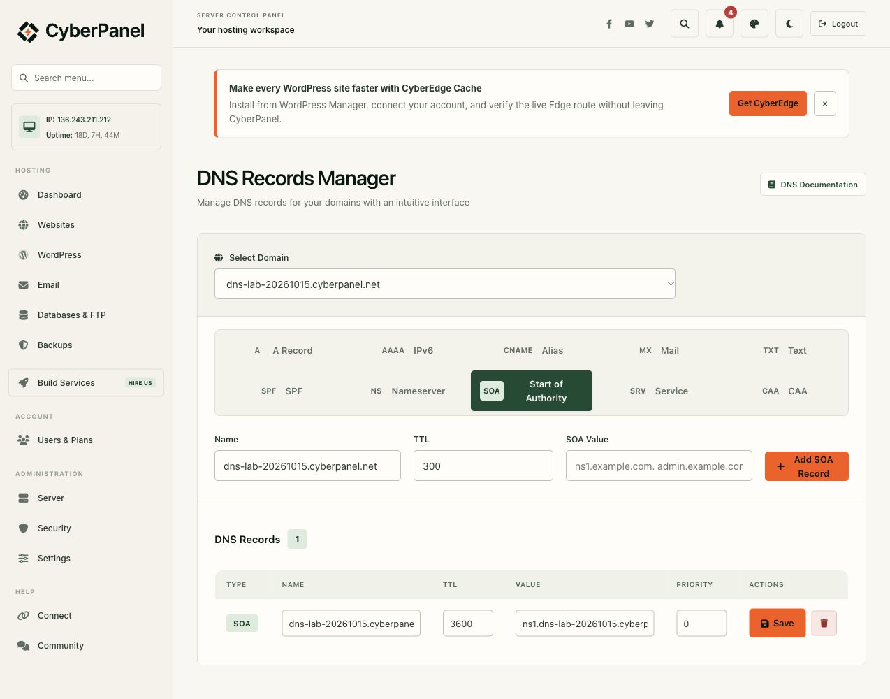

Inspect the SOA tab as well. The Start of Authority record describes the zone’s authority and includes timing information used by DNS systems. Its serial is relevant when secondary servers transfer changes, but seeing an SOA record alone does not establish that replication is configured. We inspect this record without claiming a tested secondary DNS service.
Lab zone NS records in CyberPanel
The zone’s nameserver records.
Start of Authority record shown in CyberPanel
The separate SOA view.

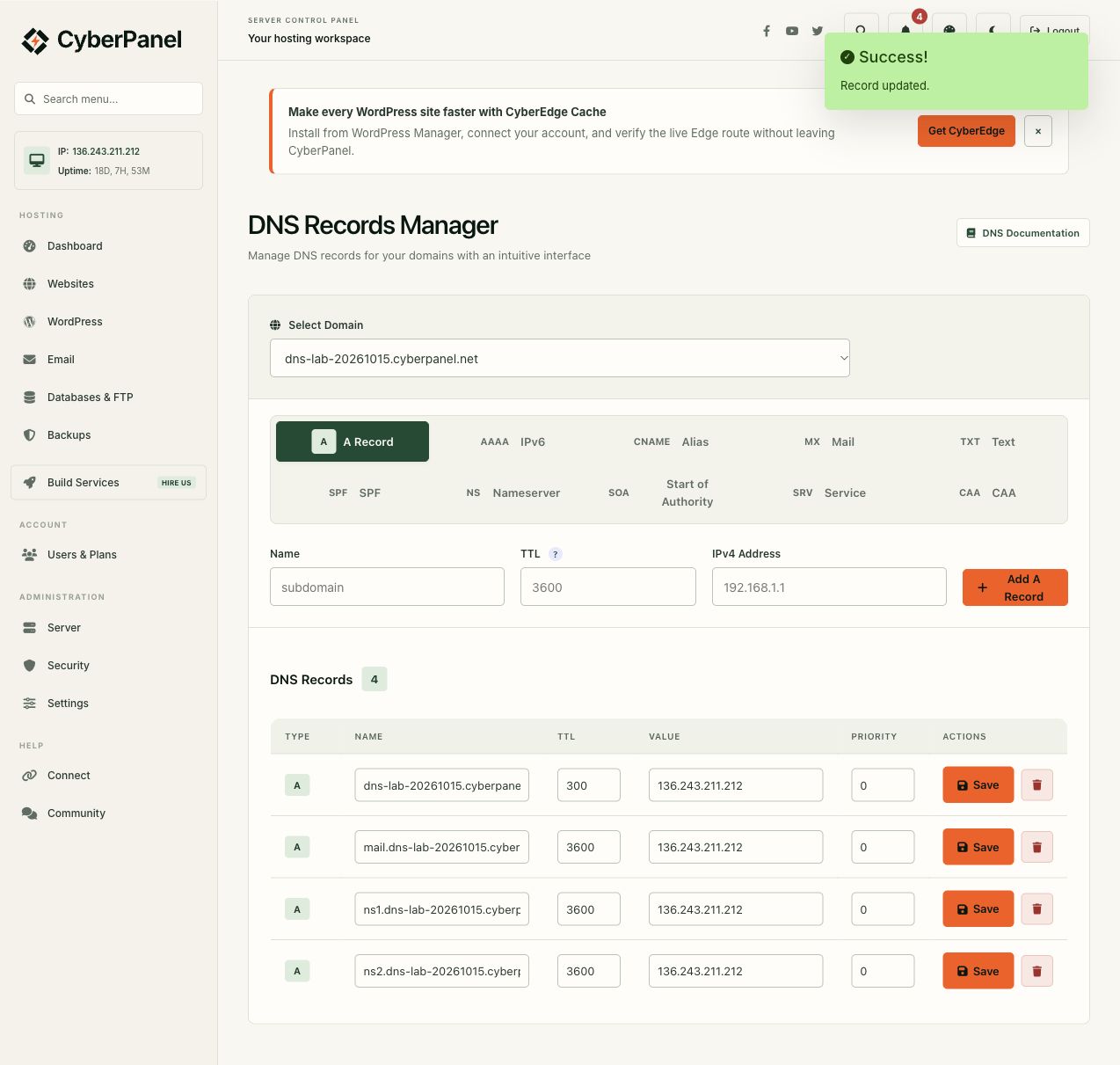

On the A tab, set the zone apex to 136.243.211.212. The apex means the zone name itself. Use the field format shown by your installed interface and inspect the resulting full name after saving. Some DNS tools accept @; others expect a fully qualified name. What matters is the stored DNS name.
Final CyberPanel A records for apex, mail, ns1, and ns2
The final A-record view: apex, mail, ns1, and ns2 point to the lab server; the apex TTL is 300 seconds.

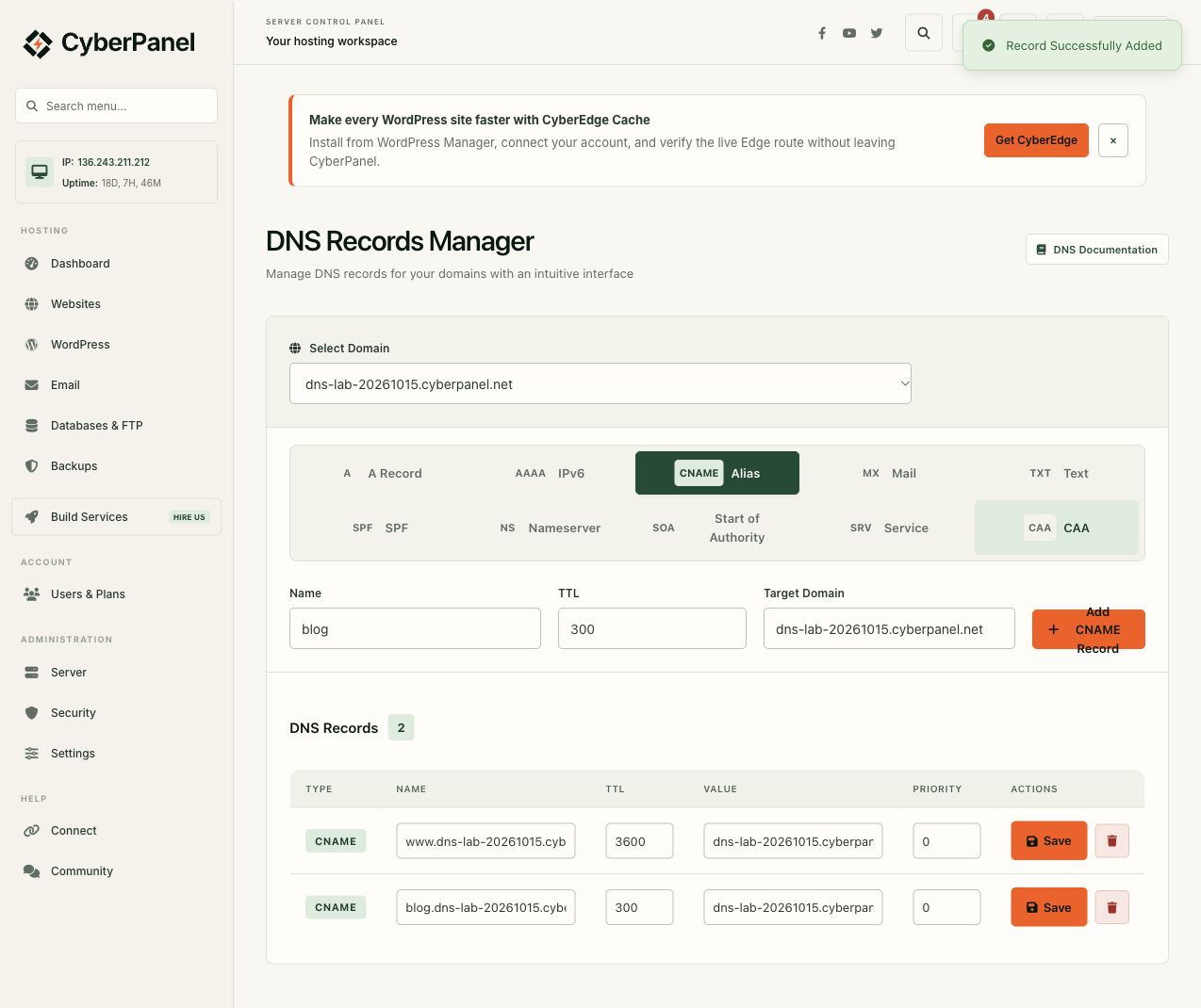

On the CNAME tab, add blog.dns-lab-20261015.cyberpanel.net as an alias of the lab apex. A CNAME points to another hostname, not an IP address. Avoid mixing a CNAME with other record types at the same name. Creating this DNS alias also does not create a website or virtual host for that name.
CyberPanel CNAME record for blog pointing to the lab apex
A saved hostname alias, separate from web-server configuration.

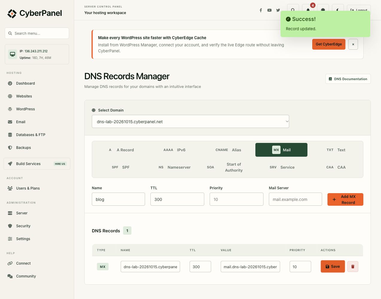

Our MX record uses priority 10, TTL 300, and target mail.dns-lab-20261015.cyberpanel.net. An MX target should be a hostname with an appropriate address record. Lower numerical priorities are preferred when multiple MX records exist. This lab demonstrates the DNS configuration; it does not provision mailboxes or establish working email delivery.
CyberPanel MX record interface showing the mail hostname and priority
The mail route is explicit: a hostname target and a numerical priority.

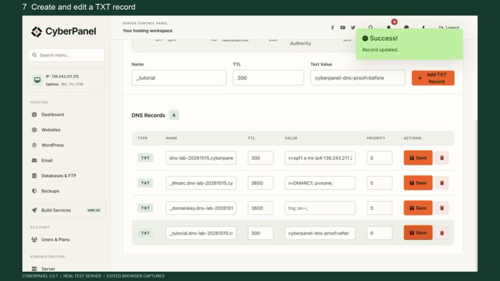

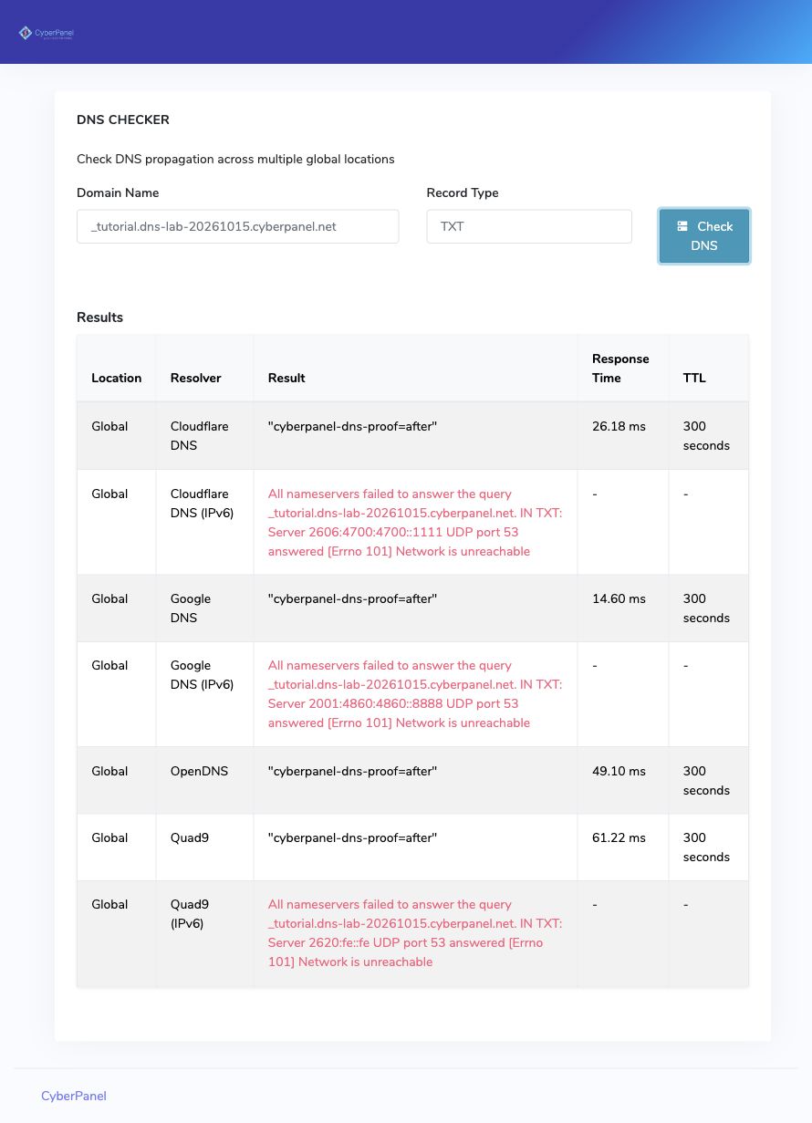

We also add a TXT verification record at _tutorial.dns-lab-20261015.cyberpanel.net, then update its demonstration value from the initial “before” state to the “after” state. The exact final value is cyberpanel-dns-proof=after. This is a convenient way to practice an edit without changing the website address. Inspect the saved value, then query the authoritative server and a public resolver separately.
Public resolvers returning cyberpanel-dns-proof=after for the updated tutorial TXT record
The final TXT value, cyberpanel-dns-proof=after, returned through four IPv4 public resolvers.

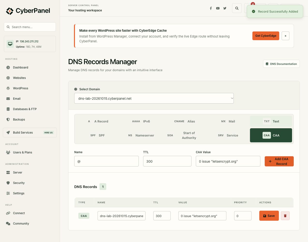

Finally, we add CAA with 0 issue "letsencrypt.org". This authorizes that certificate authority under the applicable CAA policy. It neither requests a certificate nor proves that domain validation will succeed. Keep certificate issuance, DNS policy, and service reachability as separate checks.
CyberPanel CAA record authorizing letsencrypt.org
CAA expresses certificate issuance policy; issuing SSL is a separate operation.

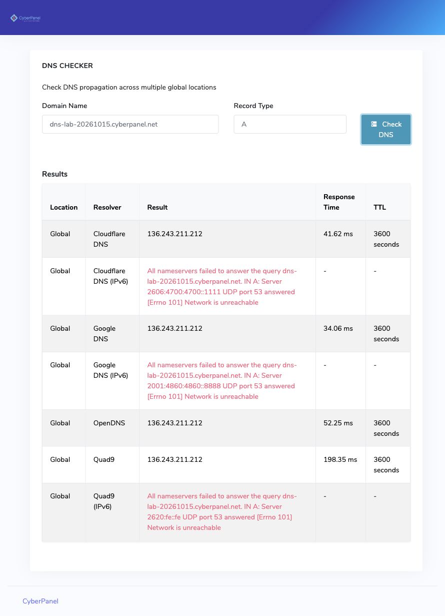

Independent checks passed all 40 comparisons: ten record questions queried through authoritative UDP, authoritative TCP, Cloudflare at 1.1.1.1, and Google at 8.8.8.8. The checks were recorded at 23:04 PKT on October 15, 2026. The saved readable verification report and JSON evidence include those results. This establishes the tested DNS answers at capture time, not application connectivity or mail delivery.
The public browser checker returned 136.243.211.212 through IPv4 resolver checks for Cloudflare, Google, OpenDNS, and Quad9. Its IPv6 transport checks reported “network unreachable” from the checker host. That error describes the checker’s network path; it does not establish a fault in this zone. It also does not turn the documentation-only AAAA example into a connectivity test.
Public DNS checker showing the lab IPv4 address through multiple resolvers and IPv6 transport errors
Read both successes and limitations: public IPv4 answers worked; the checker could not reach its IPv6 resolver paths.

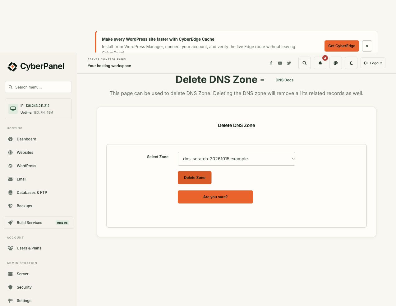

For deletion, we created dns-scratch-20261015.example and opened the confirmation dialog. We stopped before the final delete action. The screenshot demonstrates the confirmation step, not a completed deletion. Review the exact zone name before confirming deletion on your own installation, because removing a zone can remove the answers its services depend on.
CyberPanel deletion confirmation for the disposable example scratch zone
Preview only: the final deletion was not confirmed during this capture.
