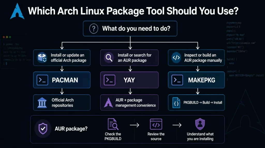

Yay vs Pacman: Which Should You Use?
The answer depends on what you are installing.
TaskBetter choice
Install official Arch packagepacman
Update official packagespacman
Search the AURYay
Install an AUR packageYay
Build a PKGBUILD manuallymakepkg
Manage both repositories and AURYay
There is no need to treat Yay and Pacman as competing package managers.
A better way to think about them is that Pacman is the core package manager, while Yay adds an AUR-focused workflow on top of it.
If you are comfortable with Pacman and makepkg, Yay becomes a convenience rather than something you depend on blindly.
Which Arch Linux Package Tool Should You Use?

What is the difference between yay and yay-bin?
Both provide Yay. The yay package is built from its source package, while yay-bin uses the binary build route documented by the Yay project.
Is Yay better than Pacman?
Not exactly. They serve different purposes. Pacman is Arch Linux’s core package manager, while Yay adds convenient AUR support and can also handle normal package operations.
Make Arch Package Management Easier, Not Careless
Installing Arch Linux Yay takes only a few commands, but the real benefit comes after the installation. Yay gives you a convenient way to search for AUR software, build packages, resolve dependencies, and keep your system updated from the command line.
Just remember what it cannot do. It cannot decide whether an AUR package deserves your trust.
Use Yay for convenience, but keep the Arch habit of checking what you install. If you understand pacman, makepkg, PKGBUILDs, and the AUR, Yay becomes a useful tool rather than a dependency you do not understand.
