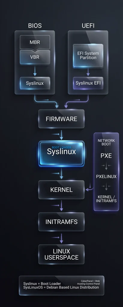

How Does Syslinux Work?
The boot process depends on whether the machine uses traditional BIOS or UEFI.
BIOS Boot
On a BIOS system, Syslinux can use boot code in the MBR or partition boot area. The boot process then reaches the Syslinux files on the boot partition.
The configuration file tells Syslinux which kernel to load and which parameters to pass to it.
A simplified configuration might look like this:
PROMPT 1
TIMEOUT 50
DEFAULT arch
LABEL arch
LINUX ../vmlinuz-linux
APPEND root=UUID=xxxxxxxx-xxxx-xxxx-xxxx-xxxxxxxxxxxx rw
INITRD ../initramfs-linux.imgHere, LINUX points to the kernel, APPEND passes kernel parameters, and INITRD identifies the initial RAM filesystem.
UEFI Boot
UEFI uses a different process. Syslinux provides EFI binaries that are placed on the EFI System Partition.
On Arch Linux, the UEFI configuration file is normally placed at:
esp/EFI/syslinux/syslinux.cfgThe BIOS and UEFI configuration syntax is similar, but the installation process is not. The ArchWiki also notes that the Arch-specific syslinux-install_update script does not support UEFI installation.

What Should You Check Before Using Syslinux?
Before installing a boot loader, take a few minutes to understand your system.
Check these items:
| Check | Why it matters |
| BIOS or UEFI | Determines the installation method |
| MBR or GPT | Changes BIOS boot setup |
| Boot partition | Syslinux needs access to its boot files |
| File system | Not every feature works on every file system |
| Root UUID | Required for correct kernel parameters |
| Secure Boot | UEFI Syslinux has no proper Secure Boot support |
| Kernel path | A wrong path can stop booting |
| Backup | Lets you recover from configuration mistakes |
