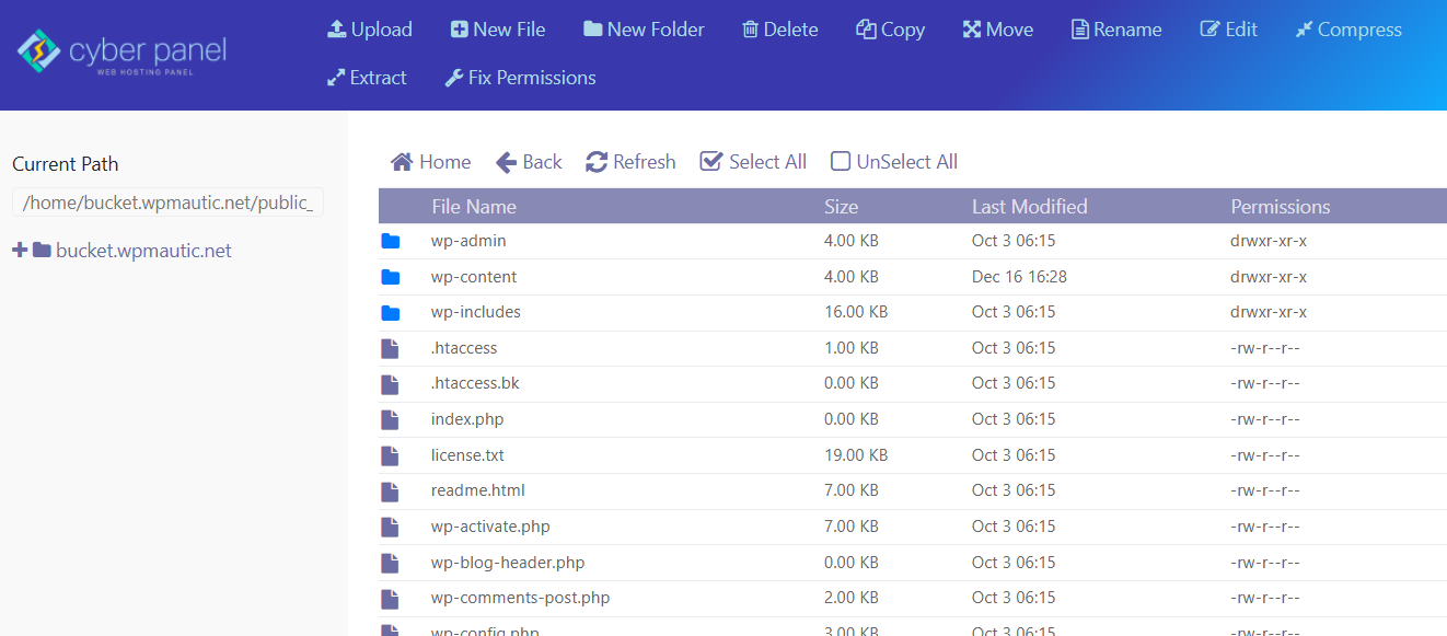

  1. Check the .htaccess File
Access your website via CyberPanel file manager. Rename the .htaccess file to set it apart. Log-in to WordPress and navigate to Settings> Permalinks, then click Save Changes to regenerate the file.
CyberPanel File Manager - 500 Internal Server Error WordPress

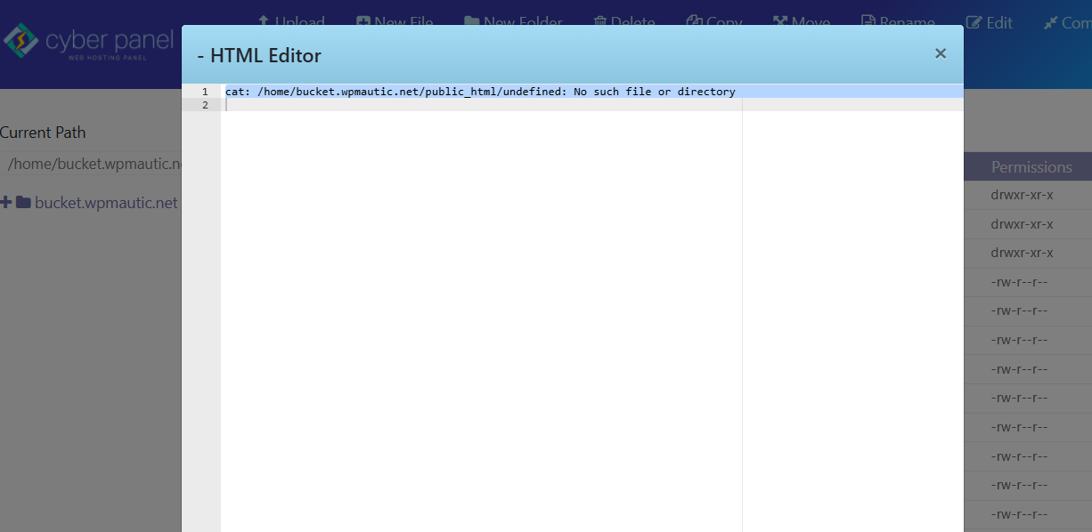

Then, increase the PHP memory limit by accessing your wp-config.php and use this code:
CyberPanel File Manager - 500 Internal Server Error WordPress 2
define(‘WP_MEMORY_LIMIT’, ‘256M’);
Save the file and refresh your website.
