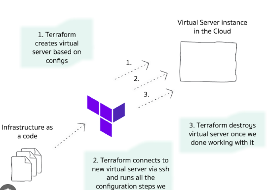

Terraform Destroy command tears down every resource defined in your .tf file. And that includes your compute instances, databases and load balancers – basically everything.
This command is used to delete the infrastructure set up with Terraform Infrastructure-as-Code (IaC). When you run terraform destroy, Terraform checks the state file to find and remove the managed infrastructure from your cloud platform (like AWS, Azure, GCP, etc.).
While the other Terraform commands (terraform init, terraform plan, terraform apply) help create new infrastructure, terraform destroy is specifically for deleting all or selected infrastructure defined in your Terraform IaC.
Unlike terraform apply, which updates resources to match the desired state, terraform destroy ensures that all or some of the resources managed by Terraform are removed.
Now, in a production setting, you usually don’t want to delete long-lasting objects, but Terraform can be convenient for managing temporary infrastructure during development. When you’re done, just run terraform destroy to easily wipe out all those temporary resources.
