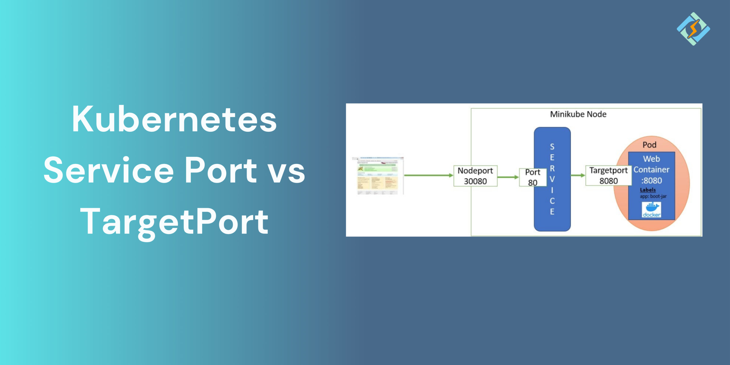

In order to well-understand the difference of Kubernetes Service Port vs TargetPort, imagine Kubernetes Services as a proxy layer between Pods and clients. The Service port is the exposed endpoint on the Service itself, while the targetPort is the internal port on the Pod where the application is indeed listening.
1. port – The Listening Port of the Service
When you specify a Service, the port is where the client will access the application. It is what the service will listen on. If you have a frontend web app that sends requests to a backend service on port 8080, then you would specify that port in the port field of the Service declaration.
This port is the one that is accessible through the Service’s IP address. Any client wanting to access the Service has to go through this port. Internally, Kubernetes will have its own kube-proxy component making use of forwarding from the Service port to the target port of the real backend Pod.
This also implies that port value is attached to the virtual IP (ClusterIP) assigned to the Service, and not the physical ports of the Pods or Nodes.
2. targetPort – The Actual Listening Port of the Pod
The targetPort is the port within the container the one on which your application is executed and listening for traffic. For instance, if your Node.js app is listening on port 3000 within the container, your targetPort is also 3000.
Kubernetes would like to know where to send traffic in the Pod exactly. Therefore, when the request arrives at the Service on the port, Kubernetes is aware to send it to the targetPort for the right Pod.
Notably, what this means is that targetPort is a reference to the actual port an implementation-specific port the containerized application is actually listening on. It may be the same port, or it may be something entirely different.
Mapping Between Kubernetes Service Port vs TargetPort
The port-to-targetPort mapping is the core of the Kubernetes Service abstraction. When you create a Service, you specify a mapping that in effect says:
“When someone sends a request to the Service on port X, route it to the Pod’s port Y.”
This mapping is performed by the kube-proxy and the underlying iptables (or ipvs) rules installed on each Node.
For instance:
<code>apiVersion: v1<br>kind: Service<br>metadata:<br>name: my-service<br>spec:<br>selector:<br>app: myapp<br>ports:<br>- port: 80<br>targetPort: 3000</code>
In this case, clients connect to the Service on port 80, and Kubernetes will forward that traffic to the Pods on port 3000.
