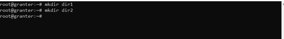

For instance, we create two directories:
  •  dir1 as the source.
  • dir2 as the destination.
mkdir dir1
mkdir dir2

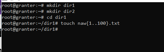

Change the directory to dir1, and then create a list of files there using the touch command.
cd dir1
touch naw{1..100}.txt

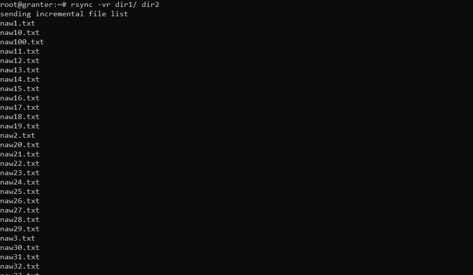

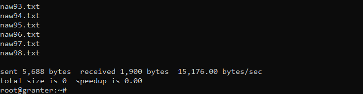

If you want to copy and synchronize the files from ‘dir1’ to ‘dir2’, you have to use the following Rsync command:
rsync -vr dir1/ dir2

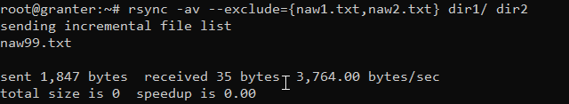

For multiple exclusions, you have to enclose them in curly braces as shown below. Here is the command to run:
rsync -av --exclude={naw1.txt,naw2.txt} dir1/ dir2
